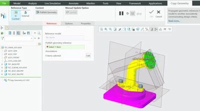

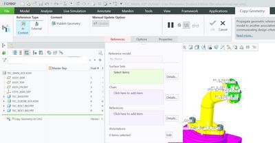

I am working with Creo 10.0 student edition, and it seems like after installation, two different versions (with exactly the same path to Program Files/Creo) exist. I.e., opening the desktop shortcut and opening the start menu shortcut open two seemingly different windows of Creo, that mainly differ in the look of the "Model" toolbar. Here are screenshots of the two "versions":
Not only the two "Model" toolbars are different, the "Copy geometry" button, that is part of the "get data" in both "versions" looks completely different in each "version":
I couldn't find any way to move from one "version" to the other from "File->Options->Customize", so my main question is:
How can I switch between the different "versions"? (i.e., if I open one of them, but want to use the other "Model" toolbar, how can I do it?)

March 9, 2024
Thank you! You are right in that the two versions differ in their Start in directories, and that indeed one of them contain a creo_parametric_customization.ui file, while the other version doesn't.
Can you please help me understand what are the advantages of each version? I wonder how it is possible that also specific function, such as "Copy Geometry" look different in each one. How is this possible?
