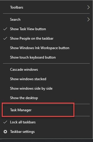

  • Open Task Manager
    • Right-click the Windows taskbar and select “Task Manager
  • Or Search in windows i.e. type in “Task Manager” and  open it.
    • Select Processes tab and confirm multiple session have been launched
    • Right click on Creo 8.0.0.0 from PTC and select End Task
  • Relaunch Creo Parametric 8 trial version
