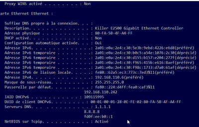

Q1: What network card has assigned MAC address MartinHanak_0-1763731842041.png?
Please run ipconfig /all  in Command prompt and publish the output.
Q2: Is it Ethernet, Wifi, USB card?
Q3: Is Flexnet already installed on your PC?
Martin Hanák
Dom_CHENTRE
(To:MartinHanak)
1/ this network MAC address is default Ethernet card.
2/ Ethernet Card
3/ Flexnet seems to be installed.

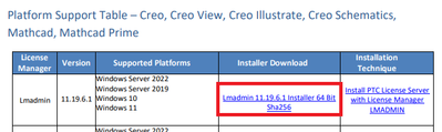

If you want to run Creo 3.0 and also Creo 7.0 on your computer then you do not have to use Creo 3.0 license. You only need a Creo 8.0 license.
To implement this variant, the following steps need to be performed:
1.] uninstall installed FLEXnet license manager
2.] download installer of latest FLEXnet license manager
https://www.ptc.com/support/-/media/support/refdocs/Creo_Parametric/compatibility/PTC_LMS_Download.pdf?sc_lang=en
3.] unzip downloaded file and run setup.exe to install FLEXnet license manager
... use Creo 8.0 license file
4.] run ptcstatus.bat from FLEXnet installation to very that PROE_EssentialsI license is available.

Reply no.1 28-nov-2025
I uploaded merged_licenses.txt file. It contains two Creo licenses:
#PROE_EssentialsI        1     Creo Essentials                           Creo 8.0 Flt Lic perm
#PROE_EngineerIII         1     Creo Engineer III                         Creo 3.0 Flt Lic perm        3A320867
Now you have to execute following steps:
If you do not know how to uninstall FLEXnet then send me list of installed programs.
Please read https://learn.microsoft.com/en-us/answers/questions/3995739/how-do-i-print-a-list-of-all-installed-programs-ap page
a.] open Command Prompt as Administrator
b.] run winget list >c:\apps.txt command
c.] send me c:\apps.txt file
3.] unzip downloaded file and run setup.exe to install FLEXnet license manager using merged_licenses.txt file.
4.] run ptcstatus.bat from FLEXnet installation to very that both licenses are available.
