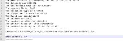

As the title suggests, I don't know if deleting my creo_parametric_customization.UI file is my only option in getting to do my work using Creo Parametric 10.0.1.0
Things worked fine yesterday.  But this morning, if I don't delete the UI file, the software crashes after showing the splash screen.
Traceback.log suggests "EXCEPTION_ACCESS_VIOLATION"
If I delete the creo_parametric_customization.UI file, software works fine.  But my ribbon and quick-toolbar customizations are gone...
And attempting to import them from the backup .UI causes a fatal error crash.
Any suggestions?
