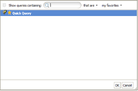

I would like to know how I can change the default setting for "My Favorites" in queries. By default when a new user logs in the "My Favorites" filter is set. How can this be removed by default? I know the user can remove it by clicking the down arrow and selecting "remove filter". I want the filter to be gone by default so the user will not have to remove the filter.
Thank you,
Dan

Hi Dan,
It is not currently possible to change this behavior but there is a logged enhancement request asking for this. See article CS88731.

Well.... now I have a slightly different question. Is it possible to add a query to new user's "My Favorites" via the CLI?

No, the concept of a "favorite" query is a GUI-only thing since there are no decorators in a command terminal. The flags for which queries are a user's favorite are stored in the database so there is no way to modify them directly. The only way I can think to set a favorite query on behalf of another user is to set-up impersonation, log-in as that user (Web/GUI), and select Add Query To Favorites which would save it to their preferences. Not trivial if you have more than a handful of users you want to set this for.
Hi Dan,
There's an RFC for this, as well: RFC 122591.
