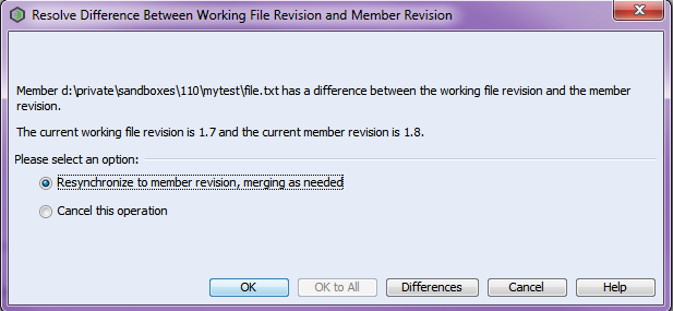

The default settings are that the first developer will be prompted to resynchronize to member revision, merging as needed:
If they choose to resynchronize and merge, they will be prompted to choose the type of merge:

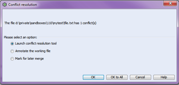

If they choose Automatic and there are conflicts, they will then be prompted to launch the conflict resolution tool.

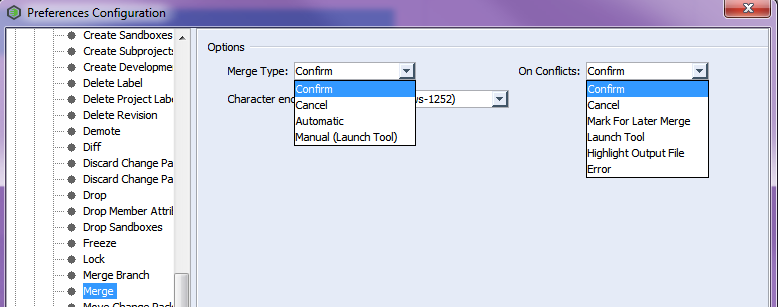

You can change the defaults in the user preferences. Select File > Preferences. Expand Configuration Management then Commands. The Check In and Merge commands are the ones to change. If you want everything as automatic as possible, then choose On Newer Revision: Resychronize for the Check In preference, and Merge Type: Automatic.
