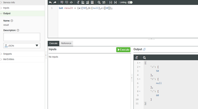

I am not sure what exactly you want to achieve, I tried the same json values and it worked like this.
Apparently, it's a bug in 8.5
Maybe it's a bug there but I tested in 9.1.
