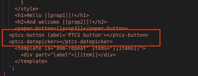

i'm trying to creating widget on line chart using polymer & sdk web component utility.
while doing that, i have imported required links into file.

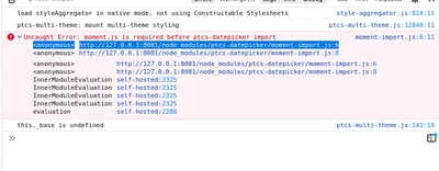

after importing and using the component, getting error "moment.js is required before ptcs-datepicker import"
To resolve this issue, i have installed moment js via npm. still it is showing same error
can anyone help me on this ??

Hi @Rajkumar_20673
We have an internal case on this that indicates it was fixed in 9.3 version of the web component library.  Which version are you running?
Regards.
--Sharon
yes, we are using 9.3 version only
@slangley , any idea about this error, it's been long time, we are not about to solve it.

Hi @Rajkumar_20673.
Were you able to resolve this issue?  Based on another post from your colleague, Shashi, is it possible you had omitted the extension on the filename?
