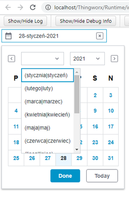

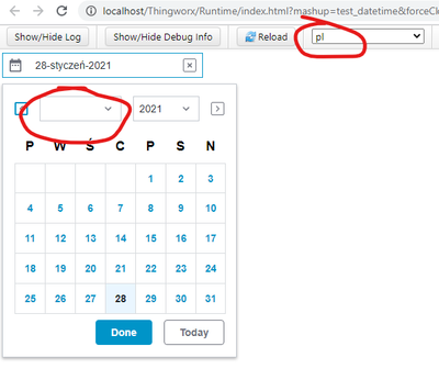

Standard datetimepicker doesn't show localized Polish month name in popup window.
ThingWorx 9.1.0-b10877
dropdown list shows the following:

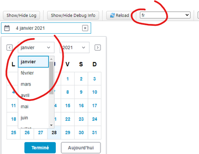

meanwhile French works fine:

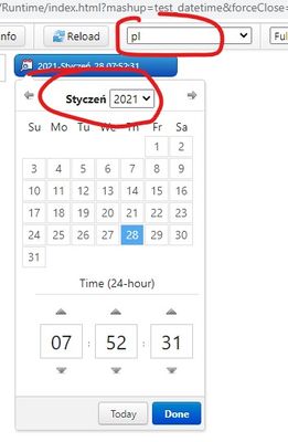

and legacy widget shows Polish fine:

Hi @Ilya,
This sounds like it could be a bug. I will do some tests and research to see if this has already been reported/fixed and will get back to you.
January 28, 2021
I was able to replicate the issue on Thingworx 9.1. The month doesn't appear in pop up on mashup load but after you select it once it appears every time until the mashup is loaded again. I don't see this issue reported before, so I will open a support ticket for this and report it to R&D. Once I get a response from them, I will post it here.
