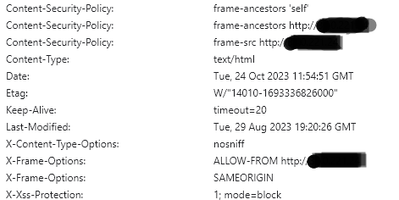

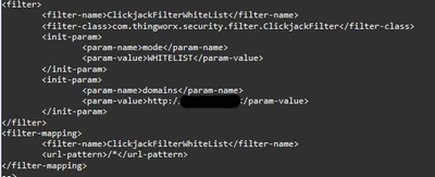

Hi, I have a problem with embed thingworx9.4 in angular, I have followed the configuration that appears in ptc (https://support.ptc.com/help/thingworx/platform/r9/en/index.html#page/ThingWorx/Help/Composer/Security/AllowingEmbeddedMashupsiniFrames.html) but it keeps blocking the connection. I attach images of the current configuration and the result of the console.
The console shows me the frame-ancestors 'self' and the allow-from, I guess it should only show the allow-from.
