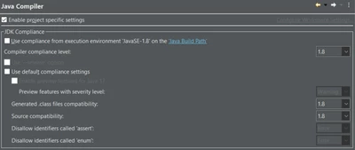

Here are my settings for the Java compiler:
I use JavaSE-1.8 which correspond to JavaRuntime 52.0 according to the documentation

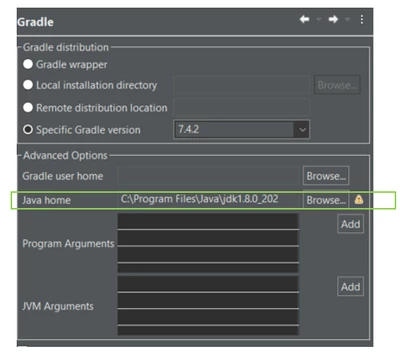

So I figure it out. My problem was the jdk used by gradle, which was the default jdk used by eclipse (jdk 11)
To change the gradle  jdk set up in Eclipse  go to Window/preference/gradle
 there you can change the java home used by gradle.
Best regards

The error refers to the ThingTemplate Class which is reported as compiled with the non compatible 61.0 version although the java compiler compliance in Eclipse is set to 1.8 (52.0)
This seems strange to me and i have no clue how to fix it.
