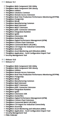

I am currently migrating projects from ThingWorx 9.3 to 10.1 and need to import several extensions required by the existing applications.
List of required extensions:
  • PTC.Base
  • CSVParser_Extensions
  • TWX_Converge_Core_ExtensionPackage
  • SCO_Common-extension
  • Twilio_Extensions
  • Mail_Extensions
  • TWX_Converge_Styles_ExtensionPackage
  • infotableselector_ExtensionPackage
  • FactoryDemo-extension
  • OA_OperatorAdvisor-extension
  • AppHomePage-extension
  • LogoutWidget-Mfg-extension
However, I am unable to determine whether any of these extensions have additional dependency extensions that must be installed beforehand.
I could not find a dependency list or reference on the ThingWorx portal or documentation that clearly specifies extension-to-extension dependencies for these packages with compatible version
Could you please confirm:
  1. Whether any of the above extensions have mandatory dependencies on other extensions
  2. If there is an official source, document, or tool within ThingWorx to verify extension dependencies before import

Hello Ayushi,
Please follow below order (independent extension)
  1. Twilio_Extensions
  2. Mail_Extensions
  3. CSVParser_Extensions
  4. LogoutWidget-Mfg-extension
  5. infotableselector_ExtensionPackage
After that follow below order (probably not exact)
  1. PTC.Base
  2. FactoryDemo-extension
  3. SCO_Common-extension
  4. OA_OperatorAdvisor-extension
  5. TWX_Converge_Core_ExtensionPackage
  6. TWX_Converge_Styles_ExtensionPackage
  7. AppHomePage-extension
    Note: After every import check application/script log, if it says dependency, import dependent one.

Hi Javed,
Thank you for sharing the extension import order and the detailed notes.
This is very helpful.
I’ll follow the sequence you mentioned during the import process.
Appreciate your guidance and support.
