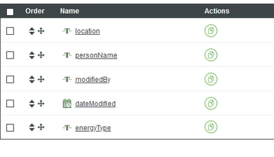

We are trying to update data table during run time and we are encountering the following exception some times. We observed like after 3 or 4 continuous operations we are getting this error.
java.util.concurrent.ExecutionException: java.lang.RuntimeException: com.thingworx.common.exceptions.DataAccessException: [1,018] Data store unknown error: [Error occurred while accessing the data provider.]
The following is the data table structure snippet, we have 2 string columns as primary key and the max number of records are less than 50 in this data table.

During our investigation we found that update data table service being called twice at the same time, one from mashup and one from another service. The script error log was throwing duplicate key for both the service attempts instead of inserting a record for one service and throwing duplicate for another service attempt.
We removed service binding from the mashup. Issue got resolved.
We can close this thread.
