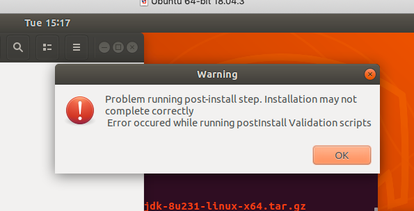

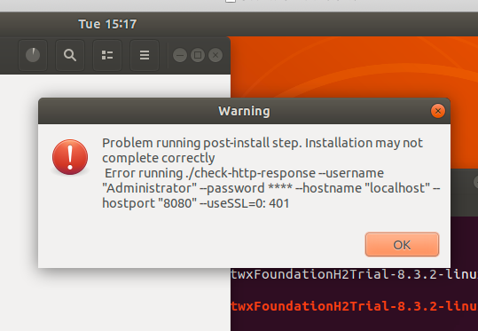

I had a version of the automated installer for 8.3.2-linux-x64 still in my file holdings.
I started with a fresh ubuntu 18.04 instance and the installation process gets much farther -- no chef client complaints.
BUT, the install fails eventually. I see 2 alerts popup
First warningFirst warningSecond warningSecond warning
Then I get a message that the install fails. I see that uninstaller is created but it does not seem to do anything when I run it.
Any suggestions appreciated for the automated installers. Do I need RHEL or CentOS?

I did get to see the install log for this attempt to install an older version of the all-in-one installer.
It seems that the install failure happens after the setup tries to change the password for the Foundation user:
Executing /bin/bash /opt/twxFoundationH2Trial-8.3.2/config/configure-user.sh
Script exit code: 0
Script output:
Script stderr:
Reloading systemd ...
Executing systemctl daemon-reload
Script exit code: 0
Script output:
Script stderr:
[19:07:42] - systemd reloaded: rc=0
Configuring Thingworx_Foundation.service service ...
Executing systemctl enable Thingworx_Foundation.service
Script exit code: 0
Script output:
Script stderr:
Created symlink /etc/systemd/system/multi-user.target.wants/Thingworx_Foundation.service → /etc/systemd/system/Thingworx_Foundation.service.
[19:07:43] - service_name service configured:
Starting Thingworx_Foundation.service ...
Executing systemctl start Thingworx_Foundation.service
Script exit code: 0
Script output:
Script stderr:
[19:07:43] - Thingworx_Foundation.service started: rc=0
Waiting for the ThingWorx Platform...
Executing ./check-http-response --username "Administrator" --password **** --hostname "localhost" --hostport "8080" --useSSL=0
Script exit code: 0
Script output:
Verifying ThingWorx Foundation connection ...url http://localhost:8080/Thingworx/Subsystems/PlatformSubsystem/Services/IsRunning
200
Script stderr:
Setting new password for the ThingWorx Platform...
Executing ./changepassword_thingworx --username "Administrator" --password **** --newpassword **** --hostname "localhost" --hostport "8080" --useSSL=0
Script exit code: 0
Script output:
200
Script stderr:
Checking ThingWorx Platform after password update...
Script exit code: 145
Script output:
Script stderr:
401
Error running ./check-http-response --username "Administrator" --password **** --hostname "localhost" --hostport "8080" --useSSL=0: 401
[19:07:58] Post-Install validation step failed after password changed check-http-response script returned ::145 writing file to mark install as failed.
Problem running post-install step. Installation may not complete correctly
[19:08:02] - The installation failed. Cleaning up
Error occured while running postInstall Validation scripts
Creating Uninstaller
Creating uninstaller 25%
Creating uninstaller 50%
Creating uninstaller 75%
Creating uninstaller 100%
Installation completed
Log finished 12/03/2019 at 19:08:05
[19:08:12] - The installation either failed [0] or the user has aborted [0] it. Cleaning up true
[19:08:12] -
Default Install Dir :/opt/twxFoundationH2Trial-8.3.2
Current Install Dir : /opt/twxFoundationH2Trial-8.3.2
Setting variable service_management_style from ps -h -p 1 -o comm
Script exit code: 0
Script output:
systemd
Script stderr:
Executing systemctl stop Thingworx_Foundation.service
Script exit code: 0
Script output:
Script stderr:
[19:08:14] - Thingworx_Foundation.service service stopped: rc=0
Executing systemctl disable Thingworx_Foundation.service
Script exit code: 0
Script output:
Script stderr:
Removed /etc/systemd/system/multi-user.target.wants/Thingworx_Foundation.service.
[19:08:15] - Thingworx_Foundation.service service deconfigured: rc=0
Script exit code: 0
Script output:
Script stderr:
[19:08:15] - systemd reloaded: rc=0
[19:08:15] - abort_action_clear_installation_folder executing
[19:08:15] - thingworxstorage_log_location : /opt/twxFoundationH2Trial-8.3.2/ThingworxStorage/logs
[19:08:15] - ThingworxStorage/Logs directory does not exists or empty
[19:08:15] - Clearing Install dir retaining application log files if exists
[19:08:15] Post-Install validation step failed
Can any one suggest why the password change would fail?
