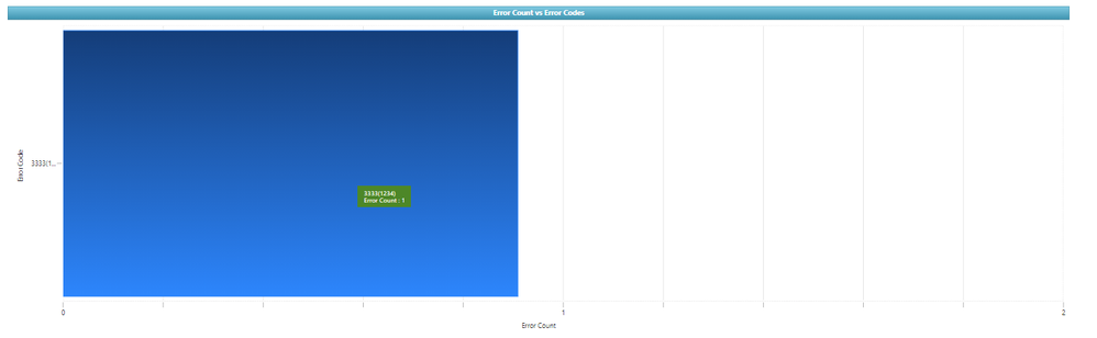

For some reason, the horizontal bars of the label chart widget does not line up with the y-axis values.  I have a value of 1 but the bar height looks below 1.  This occurs with other values as well.  Please see the image below.

Hi @Willie.
According to the internal ticket, it was addressed in 9.0 per jira TW-70626.  The following widgets were added in 9.0, so specifics about each one were not explicitly called out in the release notes.
Bar Chart Widget
Line Chart Widget
Scheduler Chart Widget
Regards.
--Sharon

I am on ThingWorx 8.5.3-b123

Hi @Willie.
Improvements were made to the alignment in ThingWorx 9.0.
Regards.
--Sharon

I did not see it in the release notes for 9.0.1, 9.0.2, 9.0.3.  Was it fixed in a later version?
