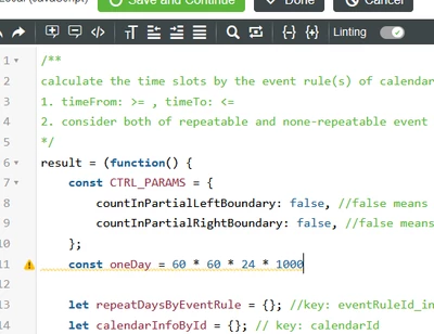

How to customize the setting of the Linting of the javascript service ?
seanccc
The  current lint rule require each line end with semi ';'   ,  can I change the rule ?

Hi @seanccc ,
If you feel that the OOTB editor isn't doing the job, there's a way to change it.
https://github.com/ptc-iot-sharing/MonacoEditorTWX
It's an editor based on Monaco(the open source library for Visual Studio Code), and you'll find that it offers a far superior experience.
Follow the instructions of how to install there and you should be good to go. It changes the editor for services and the CustomCSS tab in the mashup builder.

Hi @seanccc.
I don't think ThingWorx allows changing the rules.
If interested, you can submit this as a request on the ThingWorx Ideas page.  This will allow others to vote for it in order to increase it's chances of being considered for a future release.
