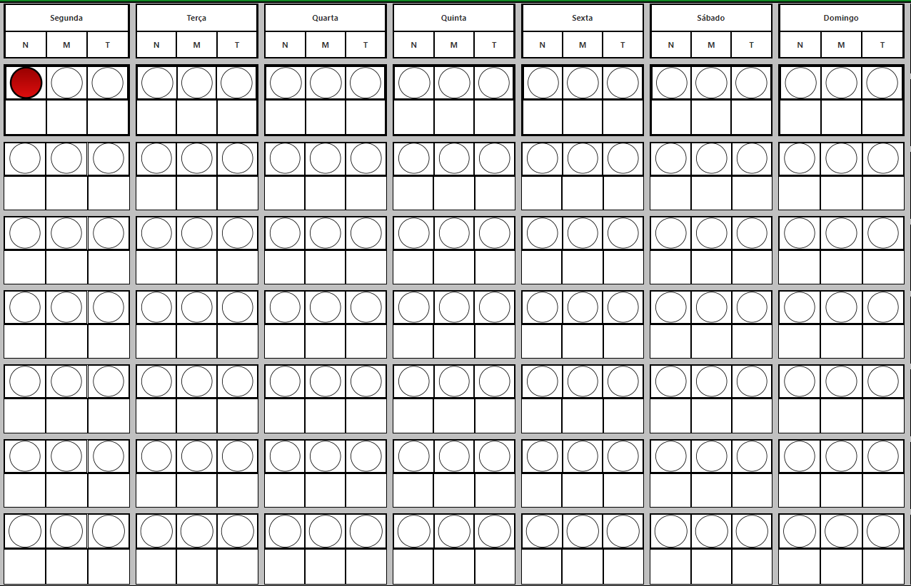

I'm currently working with a big mashup as the following:
I want to change the circles colors to red or green whenever a user click on it. And I also want to save the colors data (or just numbers) so the mashup could always show those colors.
Any help?

Could you put a transparent button (no background/foreground colour above the circle (Z-index). When it is clicked it calls a service that toggles the state of a property and sets it. Then you could use state definition on that property to decide the colour of the circle.

Thanks for the reply. Yes, this is indeed a possible solution. However, there are 147 circles, which means that I need to create 147 services to change the state of 147 properties. I wanted to do it in a more automated way like a service that indentify the widget id and change its parameters and properties.

are you familiar with the repeater widget? This widget will display any number of smaller mashups inside itself. I would suggest you do it using this widget,
Here is part an example
Each of the similar pictures above is a single mash up repeated many times. The repeater widget takes a mash up name as an input parameter
The number of items it displays (repeats) is determined by a GetImplementingThingsWithData( ) type service. You could write your own so long as it returns an infotable with the data you require for each single mash.
Doing this way you can create a mash up that is just one of your rectangles
then use the repeater widget to display the mashup below. The beauty of this way is that you would only have to write 3 services (one for each circle above). also you would not have to change your 'big' mash up if the number of things (each rectangle represents) changes in future.
