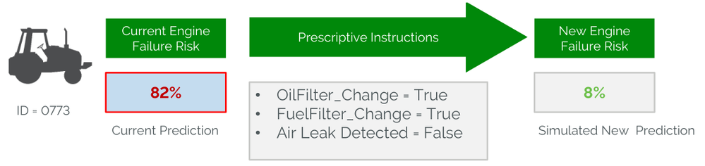

My goal is to explore the scope/limitations of Thingworx Analytics and the technical requirements to transform the business problem to an IoT + Analytics project, and to be able to explain these points to potential customers. Ideally it would be great to have a mockup on Prescriptive Models to show the great potential of Thingworx Analytics, but Predictive Models are enough for now. Any information that complements the prediction, such as the likehood of the prediction, is appreciated. For this purpose I have been studying the field weights of the Predictive Scores.
