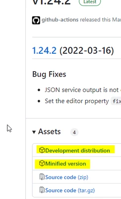

Hi @LC_10152029
Any issues you encounter using that third party content should be reported in the GitHub Issues section of that project.
Considering this, please report this issue there: https://github.com/ptc-iot-sharing/MonacoEditorTWX/issues
I strongly suspect that you did not import the correct extension, as the release contains the metadata.xml file, but let's continue the discussion there.
You need to import one of the highlighted zips from the releases page https://github.com/ptc-iot-sharing/MonacoEditorTWX/releases :
I assume you tried with the sourcecode.zip file.
Edit: But you only need to import the extension if:
See installation instructions https://github.com/ptc-iot-sharing/MonacoEditorTWX#installation .
