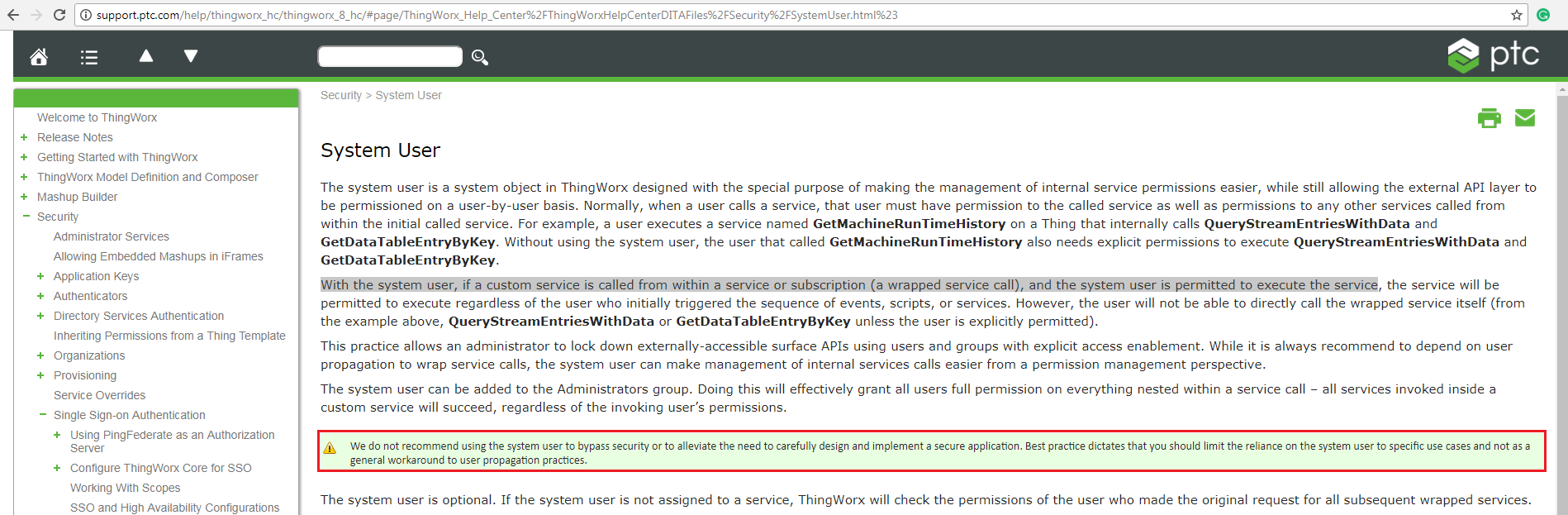

Here is the definication about System user from ThingWorx Help Center
Regarding to this explanation , the system user muse be pemitted to exectue the service (for your case, it's getDataTableCount()).
It also point out that carefully use system user, and do not use it as a general workaround.

Please also grant the user, named 'System', run time permission on data table 'A'.

Hi  Li Liu,
'System' user is a Thingworx system object,we don't require any permissions for the system object.
That's why I was trying out this system user that should internally manage permissions and invoke the wrapped inner service,however it didn't worked.

Hi Li Li Liu
Thanks for the help, it worked
