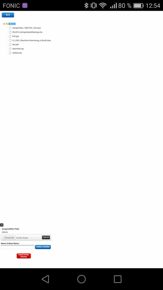

Hello everyone,
I have created a Mashup that should be accessed via mobile. Unfortunately the resolution is too high, so the mashup looks something like this:

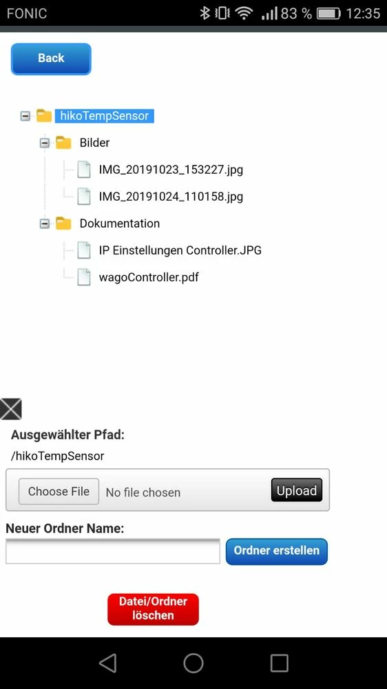

Now I know one could use static Mashups and so on, but what I found out is, that if you display the very same mashup in the VuforiaView App in a Webview it looks like this:
Which is exactly the way I want it to be. So there must be a mechanism which displays the mashup in a way the View App does it.
Does anybody know what to do in order to display the mashup the same way in a browser like e.g chrome (on mobile!)?

Hello Dominik,
I just had a look at the information provided and was curious if this issue pops up on other devices or mobile browsers as well. Have you tried any other devices or browsers?
If this seems isolated to a specific resolution we could look to open a case and file a defect.
drieder1-VisitorAuthor
November 15, 2019
Hello @tmisner,
thank you for your reply. Unfortunately (or fortunately?) the issue appears regardless of the used mobile device.
I have also tried it with mozilla firefox and it behaves the same way.
I am wondering what the display size actually depends on... Since the mashup is dynamic and I use layouts for every "Container" it would be so nice to have it in the browser just like in the view app.
November 15, 2019
Hello Dominik,
Thank you for the update on this one.
To me it seems like this may indeed be a defect with respect to the Mashups not correctly picking up that they are being displayed on mobile. When this happens they should resize correctly.
Could you please share an export of your Mashup along with what version of ThingWorx you are on so I can test this locally?
