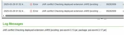

But While importing I am getting .jar file conflict error. So I tried to below steps to resolve this issue.

I will start my reply by stating that the Parsley extension is not a PTC supported product - it was developed by a former PTC employee.
Regardless, the easiest way to try and solve this situations is by removing the respective jar files from the Extension zip file itself (not from other folders) and from the metadata.xml, where those jars are referenced.
Once that's done, and if the existing JAR libraries are compatible with the extension functionality, you can retry the extension import and it should work fine.

I will say this is an unfortunate situation because you're exactly in the situation I wrote in bold above. Specifically, the "org.apache.poi.util.StaxHelper" class was introduced in Apache POI version 3.17.
Your option is to rework the code to use the XMLHelper, which is available before 3.17 - you need to download the source code and rebuild the extension in this situation.

To my knowledge, TWX does not come with POI libraries. So if you have a conflict, that means some other extension you installed uses POI in another version. So you could also try to find out which extension it is and a) remove it or b) remove the POI libs from that extension instead of the parsley extension.
