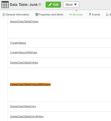

ague
(To:PaiChung)
So then I will assume that this screen shot, attached, is a bug, which PTC will fix.
(blacked-out content is my datatable name)
It's not a bug -- you can put some logged properties on a data table, associate a value stream with it, and query / purge those properties via those services. They have nothing to do with the content of that data table though.

ague
(To:ague)
There seems to be no such service as you are referring to. I've taken a screen shot of what is available (attached).
** I also triple-checked that the entity in question is instantiating the 'DataTable' thing.
