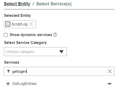

I need to read the SciptLog file from Thingworx to check the activities of a particular process. Is it possible to read the ScriptLog content from Thingworx ?

You can use the GetLogEntries service for script log and bind it to grid as shown in below screenshot,
In the Add Data section search for ScriptLog and then search for GetLogEntries service,
