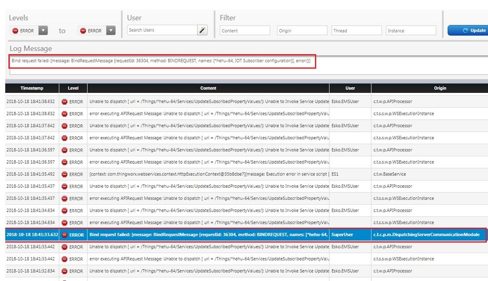

We are using .Net SDK for edge implementation. Sometimes it gives "Bind request failed" error and connection doesn't happen but sometime client gets connected to server still the same error is thrown. Not able to find the exact root cause for the issue.
Here is the SDK logs.
2018-10-15 13:55:49.791Z [L: Information] [T: 4] [U: SYSTEM] [O: IotSubscriber.IotSubscriberService] Service started!
2018-10-15 13:55:50.601Z [L: Information] [T: 14] [U: SYSTEM] [O: com.thingworx.communications.client.ConnectedThingClient] Websocket connected and authenticated
2018-10-15 13:55:50.606Z [L: Information] [T: 16] [U: SYSTEM] [O: com.thingworx.communications.client.ConnectedThingClient] Websocket connected and authenticated
2018-10-15 13:55:50.967Z [L: Error] [T: 5] [U: SYSTEM] [O: com.thingworx.communications.client.TwApiWrapper] [Error] twMessaging::handleMessage: Response ID 2 has code 160: Binding failed, see server log for more information
2018-10-15 13:56:05.969Z [L: Warning] [T: 5] [U: SYSTEM] [O: com.thingworx.communications.client.TwApiWrapper] [Warning] twWs_Connect: Already connected

What versions are you using, for both SDK and the platform?
Is there anything in the application log on the ThingWorx platform side?

.net SDK version - 5.7.6.3407
server version - ThingWorx 8.2.1-b140
Application log screen shotApplication log screen shot

I apologize for the late response, for some reason I did not get notifications about this. Do you have a firewall enabled, perhaps? Could you please share your configuration too?

Sorry for the late reply, Yes, We have firewall enabled. Which configuration you want me to share?
