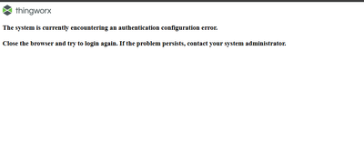

I am working on SSO SAML integration with Thingworx 9.3.4 using OKTA. and stuck with the below thingworx error apperating in Application log.
Need advice on what might be the issue. I have double checked and validated the path, permission, password mentioned in KeyManagerSettings json parameter in sso-settings.json file.
The error:

Hi Surya,
Thanks for the link, but this issues was related to temporary files that gets created during TWX service start in ssoSecurityConfig folder. I removed the them are restated, the service is starting successfully. But ever after the SAML authentication, the Thingworx page is redirected and stuck here.
Any Idea on what's causing this ?
There is no error in SAML response by the way. I checked using SAML Tracker .
Thank you.

Hi @SV_10197221,
Are your passwords encypted in sso-settings.json? If so, set the passwords as plain text and see if it resolves the issue. Then follow the Help Center to re-encrypt the passwords if needed.
