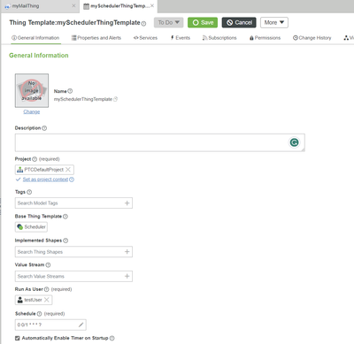

a. mySchedulerThingTemplate

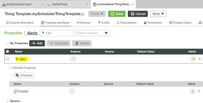

and property to store jobID

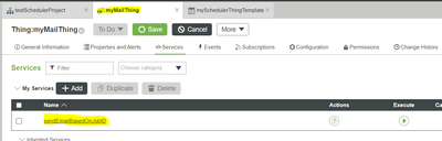

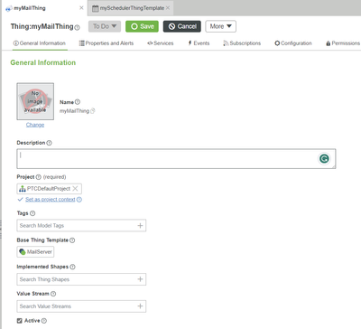

b. email service thing myMailThing
And service to send mail based on Job ID
Step 1: Create Scheduler ThingTemplate say 'mySchedulerThingTemplate' using Scheduler ThingTemplate ( Refer 'a' )

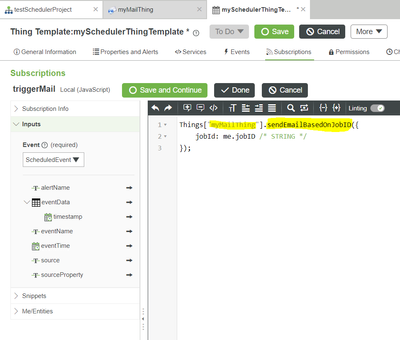

Step 2: In mySchedulerThingTemplate create a service/subscription (based on your use case & jobId will be your input) and call service from "myMailThing" (Note: Make sure subscription is enabled)

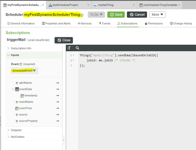

Step 3: Create dynamic Schedulers through Mashup using ThingTemplate "mySchedulerThingTemplate"
So whenever an event is triggered, "myMailThing" service will be called in dynamic schedulers

Step 2: In mySchedulerThingTemplate create a service/subscription (based on your use case & jobId will be your input) and call service from "another Thing"
So whenever an event is triggered "another Thing" service will be called in dynamic schedulers
