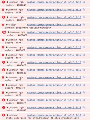

I am using Style Theme for around 50 Mashups, but suddenly labels, font weight and family are not working.
When I open the Mashup in the runtime, in the console, I see the below errors:

@pshashipreetham can you share your Mashup xml file and tell the version of your thingworx instance?
Hi @wcui ,
Thanks for the response. Mashup.xml will have a lot of dependencies, so it can't be shared.
Thingworx Version: 9.3.0

Did the issue suddenly happen? I mean is the style theme used to work normally? if yes, can you try a different browser or try clear cache?
besides, can you create a simple demo Mashup using the same style theme? if issue also reproduce there, please supply the demo entity and style theme.
Hi @wcui ,
So, the issue suddenly occurred, appearing in new mashups, too.
When I change the font-weight from Normal to Light, then Light to Normal, and Render on Runtime, I can see the Font weight as normal on the runtime.
I have checked in different browsers and incognito mode.
I will try to share the demo Mashup if possible.
