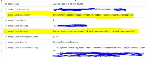

I would like to learn when thingworx return a timeout or connection refused or 404. I put to you in context, we have a simulated device that send data to one thingworx endpoint each 15 seconds, and sometimes we receive the next errors:
    • timeout errors (Appear in our log as "Task cancelled" as a connection attempt will timeout after 5 seconds.)

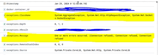

    • Connection refused error (Connection refused only occurred 3 times, the others more often)
    • 404 error
Here I can put some logs:
timeout error - reference to TaskCanceledException
Connection refused
