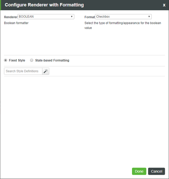

Maybe it will help you if I explain the problem better. So in previous versions there was a property called 'ValueFormat', which gives you a button to go to Renderer and State. The screen looks like this and gives you the options 'Fixed Style' or 'State-based Formatting':

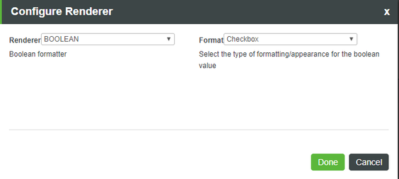

Now, in 8.5 in the property 'ValueFormat', you get a button called 'Renderer', which brings you to this screen:
So state based formatting is not possible anymore on this widget. Is this intended? How should we from now on approach state based formatting?

I understood the problem initially itself. Couple of customers have reported this as well. This feature has just not been implemented yet but is being considered. As of now, if you require state based formatting unfortunately you will have to continue to use the legacy value display widget itself.
