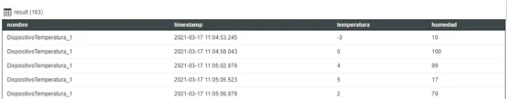

My problem is that I want to choose multiple items in the list and I want the historical data of the device appear in the chart. I have a service that receive a infotable from the list and get the historical data of the devices selected. The result of the service historical data is the following image when a I put in the input 2 devices.
but I want to binding this data to the chart. When I select the 2 devices I want a line with the historical data 'DispositivoTemperatura_1' and another with the historical data 'DispositivoTemperatura_2', but if I select 3 I want 3 lines, select 4 4 lines...
Is it posible to do? How?
Is necesary make a service for change the rows data in columns of each device?

The time series chart can auto configure itself based on the number of series in the infotable.
I have done this by have a list of Properties that are logged for a Thing (GetLoggedProperties)
and then feed that into QueryNamedPropertyHistory to get selected series.
That output then goes to the timeseries chart and it will auto render.

With the service that I said yesterday efectively works and as @PaiChung said it is autoconfigured by Thingworx (I had to change name of one field in the data shape and later it worked).
but now I have another question. Is it posible change the color of each line for device selected?
Remember that my service returns in this shape.
I want the temperature data line of my thing "DispositivoTemperatura_1" in red and "DispositivoTemperatura_2" in blue. How can I configure or what I have to do?

I think the problem is that the chart thinks only I have a series and this series is the data field "temperatura" en my case, as you can see in the legend label in my image.
And the other problem is that I want a legend label for each device. The mashup that I showed is a example and he hasn't have style.
