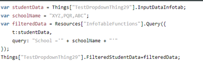

I'm trying, from a service, to run this code:
The error message I receive is: "Unable To Convert From org.mozilla.javascript.UniqueTag to INFOTABLE".

Hi @LY_10691079 ,
Have you verified that your Service - Output is INFOTABLE basetype means please print the infodata in the varibale of "result = filteredData" in your end of code or it not required means please make  Service - Output as "NOTHING".
Also I'm not sure about your query params may be not work here, Kindly refer this link - Query Parameter for Query Services
