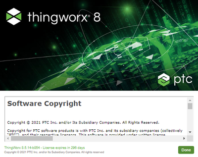

I'm unable to invoke collection CellWasClicked event in Thingworx 8.5.14, this feature working properly in earlier versions.
Widget is getting the clicked event instead cell, when we click out side of the widget or a gap between widget and cell then trigger happens. What if widget covers complete cell?
When we upgrade from 8.5.11 to 8.5.14, this collection features are not working.

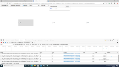

@Janakiraman-P : I tested with the entities you provided. The CellWasClicked event is working fine . I have also bound this to a status function message and its getting called on this event only along with the service 'Getpropertyvalues' when I click on the cell and not anywhere else. Can you please try in an incognito window ?
Hi @abjain ,
Please check out the attachment here.
I have already tried in incognito mode and even cleared all the cache items, still unable to trigger.
---Thanks,
Janakiraman P
@Janakiraman-P : Thanks . Now I was able to reproduce it on 8.5.14 and also on 9.1 thingworx. I also tested it on 8.5.10 twx where its working fine. You will have to raise a support case for tracking this on a case if its a bug.
