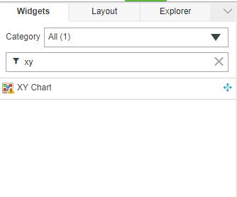

XY chart widget is not present in thingworx 9. How to get it ?
Solved! Go to Solution.
Hi @AP_9587236
It is available on ThingWorx 9. I've checked on 9.2 and 9.3.
You need to change the category on the widget panel to All then you can see the XY Chart widget
To note that this widget will be deleted in future version of ThingWorx. So you might consider to replace the XY Chart widget with the Line Chart widget as written here.
I hope this helps you

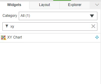

Hi @AP_9587236
