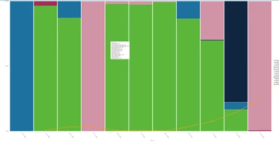

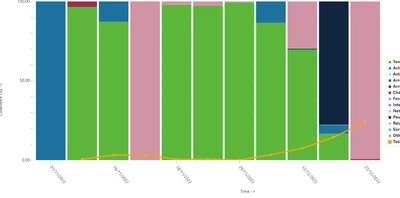

Hello Everyone,
I'm facing an issue with the label chart during runtime. Xaxis labels are showing alternatively when the mashup is viewed in chrome (100-67% Zoom), with zoom less or equal 50 all labels are showing.
Has anyone faced this issue before? How can I show all the labels even with 100% zoom on all screens?
Please share your valuable inputs.
Thanks in advance,
Bhavya P C

February 28, 2023
There seems to be no function for your case in the Label Chart.
So I recommend switching to the bar chart with the ChartType "Column Chart" (or "Pareto Chart Widget (Themable)") and possibly some configuration effort to keep the style.
