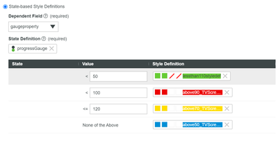

i have tried this by using shape widget but i got the output in single color or single data. Now please suggest me how i design this chart with multiple colors or data. Or suggest me if there is any widget would use instead of shape widget. below m attaching the output of shape widget where i got only single color or data:-
Have you tried to apply a state definition in the 'State Formatter'?
That should get you what you are looking for I think.
Hi @PaiChung,
Yes i have tried to apply state defination in state formatter but still getting a single color:-
please share a solution as soon as possible
ahhh right ... it will only show the color of the value.
