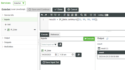

While fetching selected date from datepicker widget, i want to hardcode time as 23:59:59.000.
For example if 23/03/2022 is selected in datepicker widget means, while storing data i want tostore as 23/03/2022 23:59:59.000 in datatable. It should work correctly in all timezones. how to do this?

Can you please try with the JS function of " setHours (23, 59, 59, 000) " when you are storing the data in your service.

For me, output time is changing based on timezone offset. I dont want this to be happened.

After made changes based on offset time, still setHours are not working.
