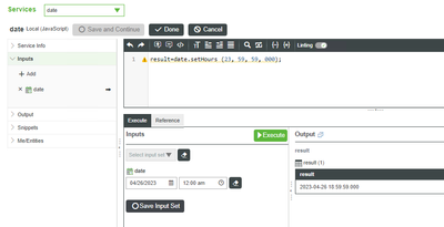

Can you please try with the JS function of " setHours (23, 59, 59, 000) " when you are storing the data in your service.
It may help you.

After made changes based on offset time, still setHours are not working.

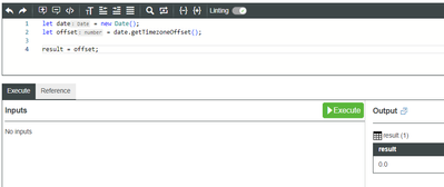

From my tests, the .getTimeOffset() function returns zero as the platform is set to UTC.
So no, that won't work.
