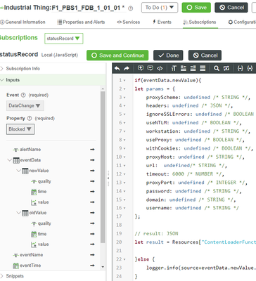

Now i know we can listen on  thing single property value change in a  Subscription , but i want to listen  thing all property value change in  Subscription, i have to create many  Subscription with all property .Is there any way i can  achieve this  with single  Subscription?

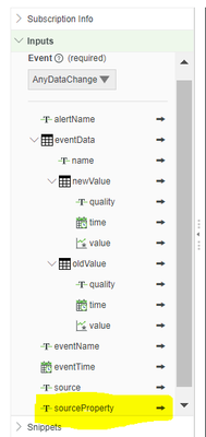

Have tried with Event "AnyDataChange" in subscription. It may helps to get event based on any properties change in that thing level.
