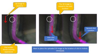

Is there any method to locate the 3D image uploaded in the resource at the location of the click in the Vuforia View. For eg, I wanted to place the image of the exclamation mark(!) for certain location to review it later.
I came to know that the pageX and pageY can be calculated but I don't have the idea about how to use this value for locating the 3D image in vuforia view.
tml3dRenderer.setTranslation(name,pos.x,pos.y,pos.z);
Please suggest If there is another way such as drawing the line in canvas for marking purpose for certain location in Vuforia view.

I am talking about the use of the mobile device (Ipad pro) with model tracking experience.
I want to place the uploaded 3d image in front of the 3D CAD model, strictly on the location of the click.
Please see the attached image for the reference.

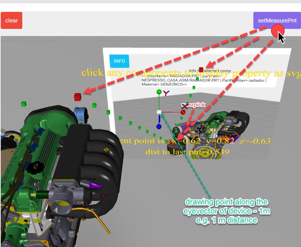

thanks for the feedback. Understood. OK this is not directly possible (my knowledge at the current functionality ) but I see 2 possible approches there what we can use.
Click on screen - will be the more difficult way. Wo we need to check 2 D coordinates and then depending on the device resolution to calculate them :
- 1.)first calculate the 2D point coordinate of the click - transform it tto the current device postion (what we can get from the tracking event) paralell to screen
- then we can find the nearest to device bouning box point of the model and let say , calculated the the item in ratio of 10% from model bounding box nearest point to the screen plane. (this is the vector which is normal to the screen plane and startss from the transformed 3d point ( 2d to 3D Space click point)
So this requires some calculation so far I see.
-2.)the second approach is to click on a visible component and take the middle of the bounding box as reference and then do a vector between and screen location and select 10% from the model > as bounding box diagonal. This dpeneds on the size of the component and distance to the model etc. This is approach with a similar compexitity as 1.) but has the advantage that we do not need to do some device specific calculation and will stay always in the 3d room. But it requires some work 🤔
So when I have this issue I would decide the second approach. Unfortunately I do have such example for this and need to adapt some of my test proejcts to create an example.
the following key points
.- acitvate the tracking event and handle and tracking call back the eyepos, eyedir and eyeup vector
-then eyevectorRight - means Y on screen coordinate system = is normilze( crossvec(eyeup,eyevector)) - eyevector== gaze vector
- the plane vector is normilze(eyevector)
- having the eyepos, eyedir, eyeup, eyeRight you can create a Location and use it for transformation of widget coordinates. (widgets such a 3Dimages which are located in the Root coordinate system == modelwidget which is also the modeltarget 0,0,0)
-you need to shift this position form device into model direction so that you will see that widget (3DImage) between the model and device and device plane.
This is all but requires implmentation ,
Please, let me know if you have question.

I whould do this as already mentioned using some API:
clicking point in distance of the eyevector and drawing then 3D Entities between these points
