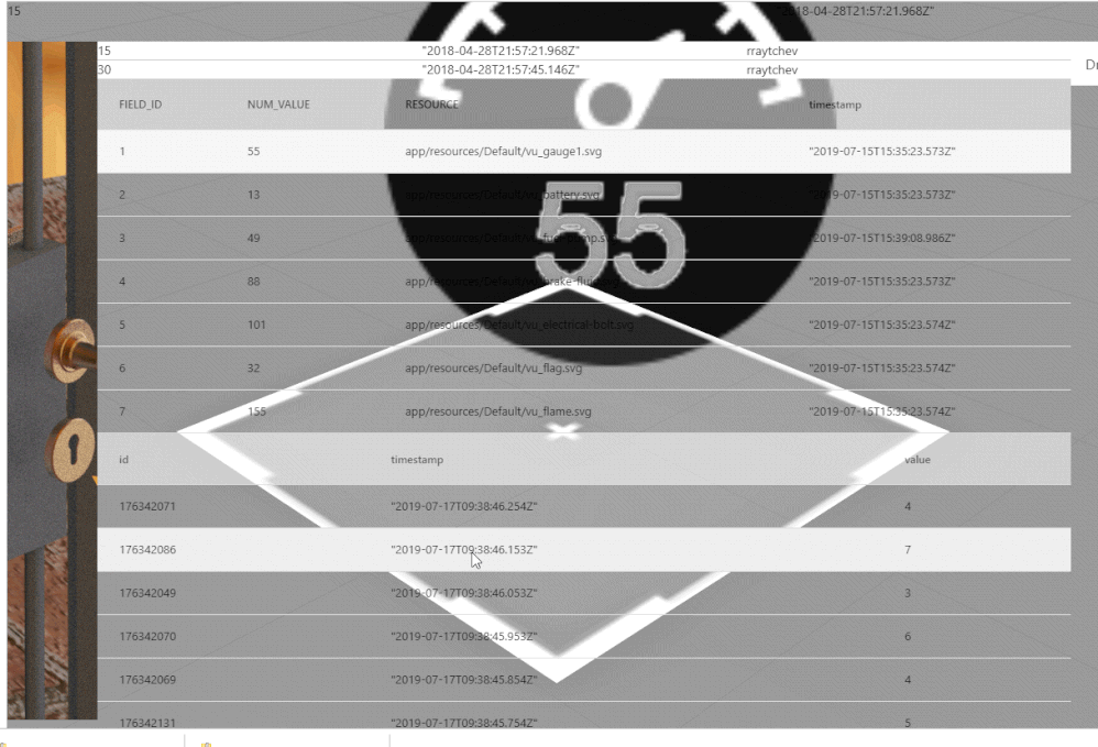

You can try to display a tree in repeater or in dataGrid widget where it could looks like a tree or with couple of list  or select widget which have some binding with TWX services or javascript
But I think it will be difficult to implement it . We have for example listener for the repeater or for the selects which could be used to handle the selection on items interactively. So, you can then filter the data with some parameters from a service to change the displayed data but I have no idea how this should looks like:
And use the listener e.g.:
twx.app.fn.clickItemInRepeater = function(item,list,isMultiSelect)
 console.log("twx.app.fn.clickItemInRepeater item"); console.warn(item);
 console.log("twx.app.fn.clickItemInRepeater list"); console.warn(list);
 console.log("twx.app.fn.clickItemInRepeater isMultiSelect"); console.warn(isMultiSelect);
$scope.app.fn.clickItemInSelect= function(list,isMultiSelect,value,valueField)
 console.log("$scope.app.fn.clickItemInSelect list"); console.warn(list);
 console.log("$scope.app.fn.clickItemInSelect isMultiSelect"); console.warn(isMultiSelect);
 console.log("$scope.app.fn.clickItemInSelect value"); console.warn(value);
 console.log("$scope.app.fn.clickItemInSelect valueField"); console.warn(valueField);
So for example you could combine 3 select elements so that the first element will show the main branch of the tree, The second widget will display a data based on the selection in the first widget and so on...
