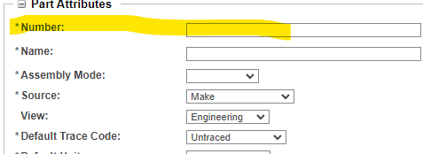

and screen shot of the ootb New Part wizard attributes, note the Label and the input are aligned horizontally, which is how I want mine to look like:

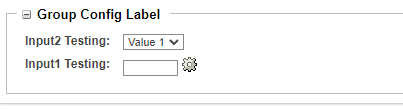

That is it!! Not sure why I had not tried that yet. Setting this to false (which is the default) the labels and inputs are rendered aligned horizontally:
