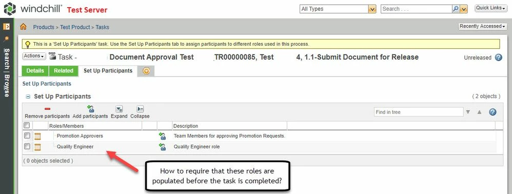

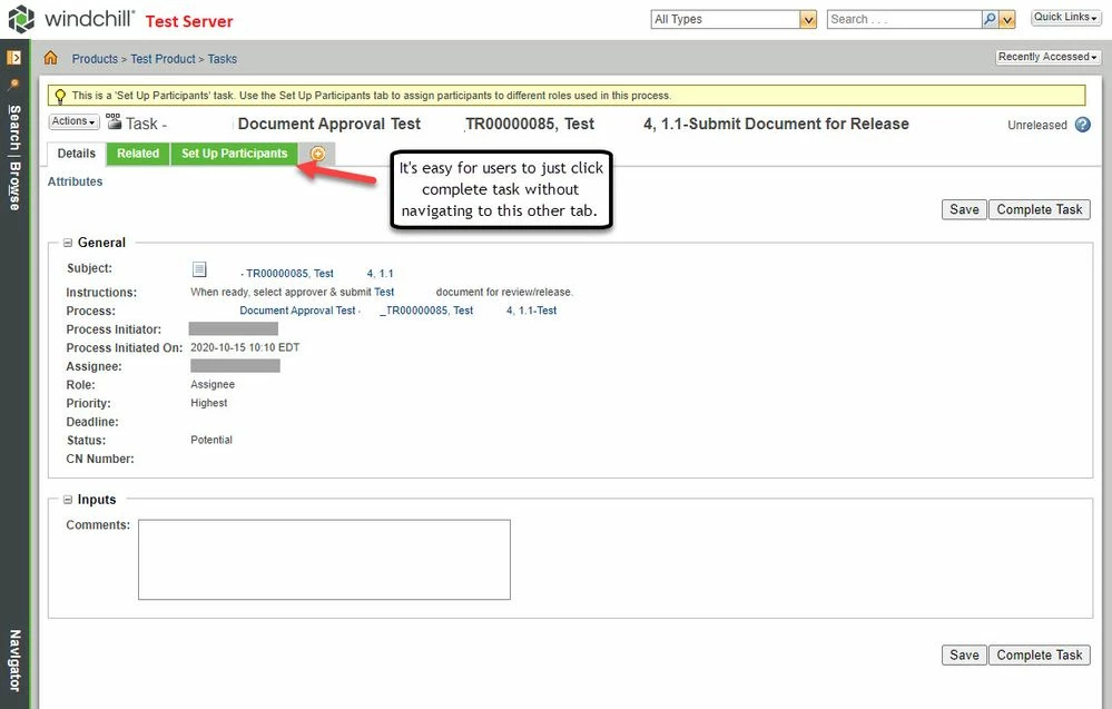

Currently, I've setup a basic document approval workflow in Windchill where the first task is to submit the document for approval and 'set up participants' of who to approve. Is there a way require that users actually 'set up participants' into the various roles? The set up participants is on a separate tab and it's easy for users to click submit without assigning anyone to the roles. Using Windchill 11.0 M030.

Run a custom server side Java API code when the Complete Task button is clicked to fetch and validate the team object that is linked to the promotion request object.
How to run Java code on the Complete Task event is roughly explained here: https://community.ptc.com/t5/Windchill/Workflow-make-comments-mandatory-in-an-activity/td-p/4546
I'm not responsible for this code, but use it in my Change Activity process.  You will have to replace <ROLE NAME> with the actual name of the role.  I believe it is the Key name that you have to use, but am not positive right now.  You will need to add it to the transitions portion.  But be careful what transition you put it in.  If you have multiple transitions like Other, MGR, Cancel, you will need to put it for the transition that you are needing to make sure. You can put it under Complete, but that will force you to always have something in there even if you are canceling the routing.  You will just have to test.
