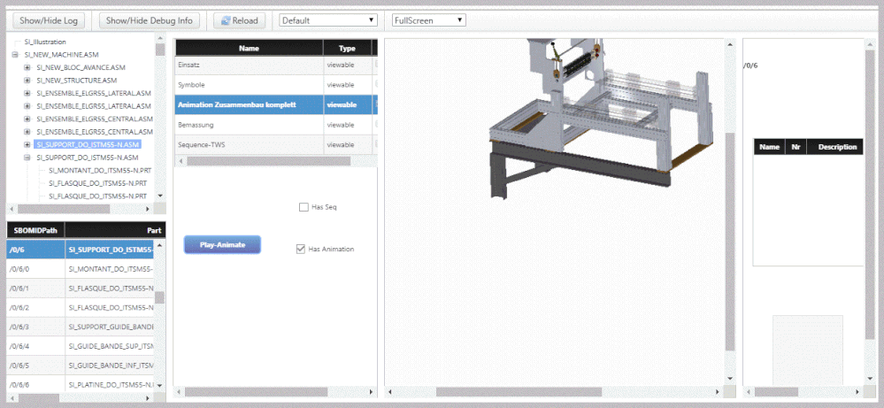

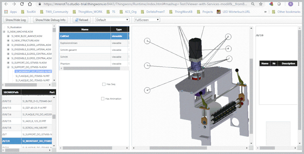

so as shown in you picture you tried to display the model in 2 different views: Creo view and thingview.
For creo View - if you try to display you mashup in chrome - it will definitely not work. It work only on windows explorer where activeX are allowed. So that I do not think, that this is a real opton for usage.
So the second view thingview should work for pvz models.

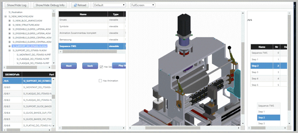

Here example (in pictures):

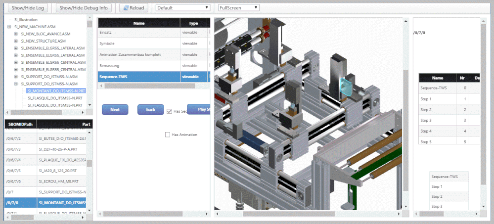

Here example for sequence and selection on element tree (requires boom see Tech Tip on AR Studio community😞
Also animations are working too.
Because it is not trivial to get this working , and could not be explained with few words , so I will not mention further details in this post.
I am plaining to write a tech tip soon in the AR Studio community - hope until end of the next week.
