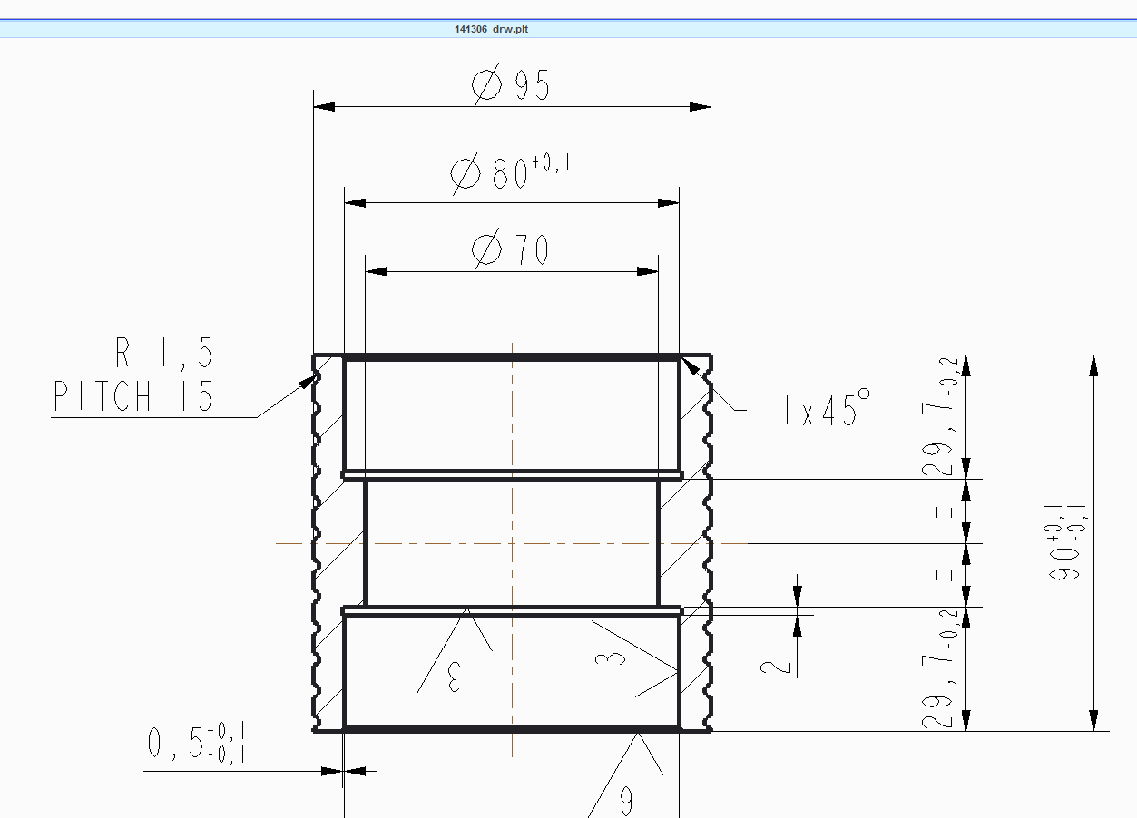

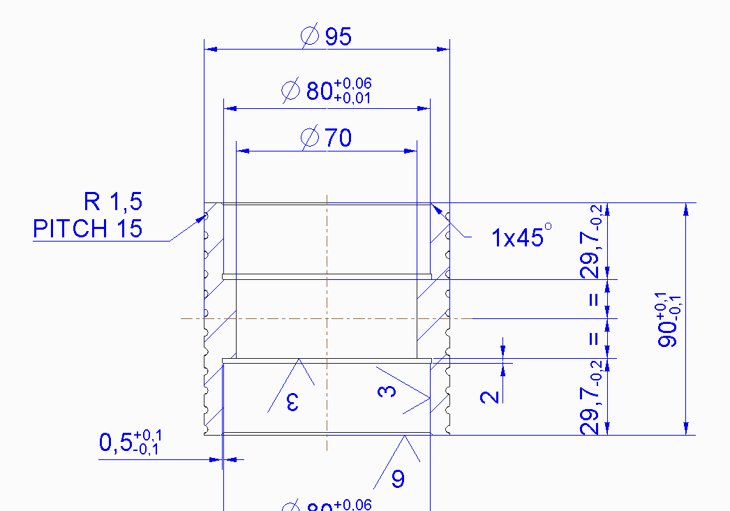

I have noticed a difference in the syle of texts between drawings opened in Creo Parametric and drawings opened in Creo View. Here below an example comparison:
the first is opened in Parametric, the second in View. The fact is that as you see, apart from the color, the text style changes and the View one is less nice and above all phrases are larger making the text emerge from the title block boxes...
It's a pity because View is very confortable for employees who don't have Parametric but need to print drawings.
Anyone knows whether or not it is possible to make View follow the fonts of the native .drw and/or to change the default one in View?

just one comment ... the second picture shows plot file (maybe it is generated as drawing viewable in Windchill PDMLink), not drw file.

yes I know, it is opened from Windchill as .plt and in fact this can be the point...maybe there is also a way to force View to open .drw in other better formats or, force Windchill to feed View with the proper file type (I don't know which one does the work, If I was sure it is Windchill's I would have posted the discussion it in the Windchill session).

the fact is that in Parametric the drawing is ok graphically, it is in Creo View opened from Windchill that the graphic changes.

Is this a "stroke all fonts" issue as far as text output style?
Hopefully just a side note but I would be way more concerned with the tolerance difference in the Ø80 dimension.

Stroke all fonts is a printer configuration setting that converts text to "lines" (for lack of a better word). In my opinion it provides a more consistent output with respect to what is displayed on-screen. I usually add it to the printer configuration file (.pcf). I'm not sure how that works with Creo view and windchill  but if you are manually creating your .plt files, I believe this will improve your consistency.
On the side note of the tolerance, I was referring to the fact that the tolerance was different from your Creo drawing to your .plt output...+.06/+.01 versus +.01. It may be just a simple screen grab at different times in the design/drafting process.

thanks for your advise, indeed I didn't know it and the fact is that in Parametric the drawing is ok graphically, maybe it is just Windchill .plt conversion that messes up fonts. In fact if I "save a copy" the drw to pvz in Parametric and then open it in View, the drawing is ok, just like as viewed in Parametric.
And I can't even suppose WC uses Parametric to create the .plt to then give to View, as .drws are openable from WC also when Parametric is closed.
Regarding the tolerance, I didn't notice they were different! And this is not due to different times but to another problem of View, that is sometimes it grabs previous version of the same file (I don't know why), it has just happened yesterday with another document...

Windchill does not retrieve the .drw file for Creo View, but uses a representation that is stored as Content with the drawing.
You have a CAD worker machine in your system that 'publishes' all drawings when they are checked in and that is what is stored as Content.
How you have the recipe file setup for publishing determines what output type is created. I output mine as PDF instead of plot files.
The settings on your CAD worker for Creo Parametric determine what the output will look like. The CAD worker will launch its own local copy of Creo Parametric to generate your output files.
If you are seeing a pvz file generated interactively that matches your on-screen image, then the Creo settings on the CAD worker are not the same as your computer.

I contacted my distributor and indeed we realized it was due to the fact that the font folder pointed by the worker was different from the one on the client machine, as well as pentables. So it has been just a matter of making them identical and set the config.pro option pen_table_file pointing the new file. Also, it was possible to edit the publishing format by using the Recipe editor of the worker machine (that is different from the client's, and that in fact was the cause of the ineffectiveness of previous modifications).
