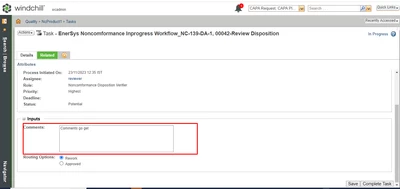

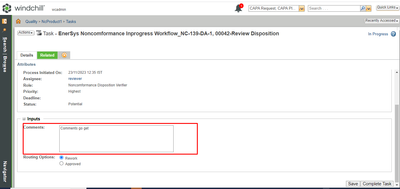

Hey @HelesicPetr Thanks for the reply
My object is Disposition Action
Internal name is wt.change2.disposition.DispositionAction action = (wt.change2.disposition.DispositionAction)primaryBusinessObject;
Pls refer screenshot highlighted comment I want to get
Could you please tell what changes I need to made in above code which you shred
Hi @RS_10128209
If the comment is from workflow you don't need to do any changes.
the comment is saved on the workflow event not the DispositionAction
You just need to run the code from the workflow task, not the workflow robot.
If you need to run the code from workflow robot, you need to change a first row
wt.fc.collections.WTArrayList auditCol = (wt.fc.collections.WTArrayList) wt.workflow.engine.WfEngineHelper.service.getVotingEvents((wt.workflow.engine.WfProcess)self.getObject(), null, null, null);
remove the .getParentProcess()
