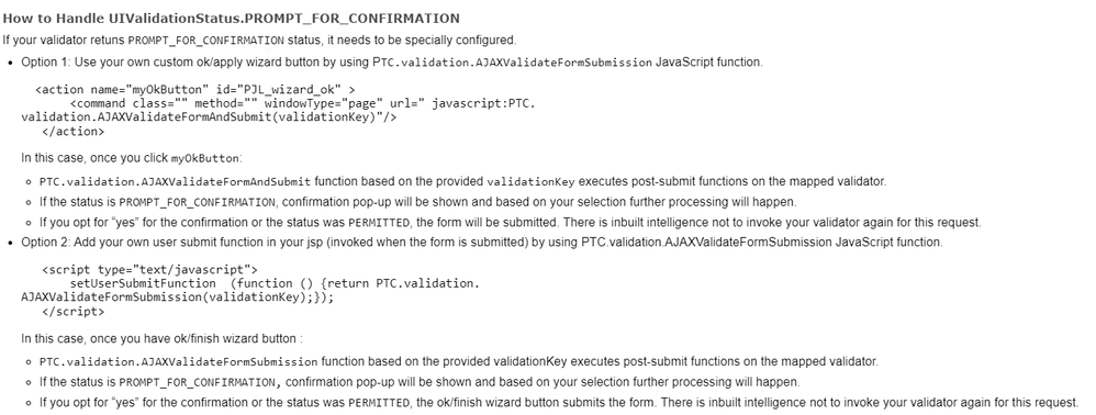

Use Case: While creation document, I wanted to implement validation for user to get popup confirmation based on some attribute value. ( if attribute value is "XX", confirm if you want to proceed further or cancel)
Description:
I gone through the PTC documentation and found below information, which is not sufficient to implement UIValidationStatus.PROMPT_FOR_CONFIRMATION  as a beginner  :
I have already wrote a logic and status also getting set (as per printing "result" in MS) for this, but just need to set the further steps to handle the confirmation popup.

Hi, I have not used UIValidationStatus.PROMPT_FOR_CONFIRMATION previously but as per your use case, I think the same can be achieved through adding the code logic under .jsfrag file and it gets invoked on complete
eg: https://www.ptc.com/en/support/article/CS35488
