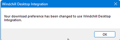

Use Case: Download preference in windchill keeps changing to use the desktop integration
Description:
I have a user who wants the download preference to be the basic browser functionality. He sets that preference but when he downloads a part number log he's greeted with this error message. Is there something that needs to be set so this stops happening?
Best answer by avillanueva
They likely saw this message when they used the desktop integration:
You can change a setting in the integration to stop this from occurring:

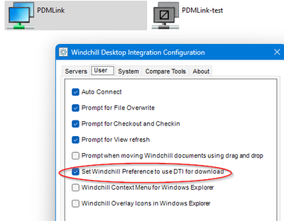

Right click on your configuration or view user settings. Uncheck this option and it should stop.
March 28, 2025
Awesome, I'll try this out!
