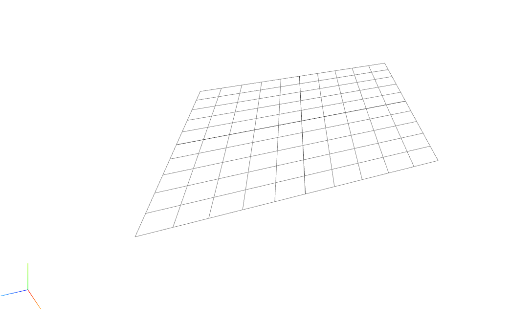

I am trying to use the 3D Model Viewer widget and am not able to view the model. The mashup is just blank with no errors.blank.PNG
July 11, 2017
Are there also no errors in the Application.log for ThingWorx when you are attempting to load the model?
July 24, 2017
You need to set the model to display.
