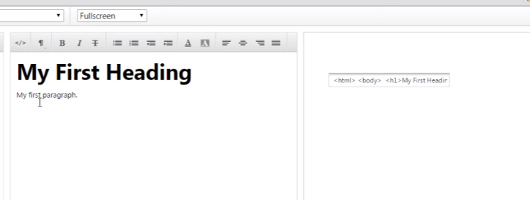

Sorry, I did not describe things clearly. I want to embed my own HTML file into thingworx. Is there any way to achieve it?Thank you
July 5, 2017
If your HTML page is published and has a URL, you can use the WebFrame widget;
If your HTML page is just codes, you can use the HTMLTextArea and bind the code to it, it can show what you want.
Here's the link for the video Thingworx Fundamentals 101 -- How to Use HTMLTextArea Widget - YouTube
